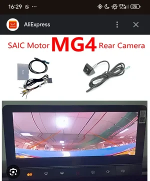

@elenc Is this the same rearview camera you installed? What two previously unnecessary cables did you have to connect to resolve the problem? Thanks in advance.
