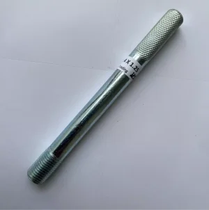

Well done @TimothyN, I use one of these to locate the wheels, it just screws into one of the bolt holes, the top one is best, then you slip the wheel onto it and slide it into position, it makes the job so much easier.The only difficulty, and it was a big difficulty, was getting the original wheel back on, which is not only a lot heavier, but you can't see the central hub. But that would be done by the garage IRL, so not a problem.
I bought a similar one of these myself and it was a big help !.Well done @TimothyN, I use one of these to locate the wheels, it just screws into one of the bolt holes, the top one is best, then you slip the wheel onto it and slide it into position, it makes the job so much easier.
