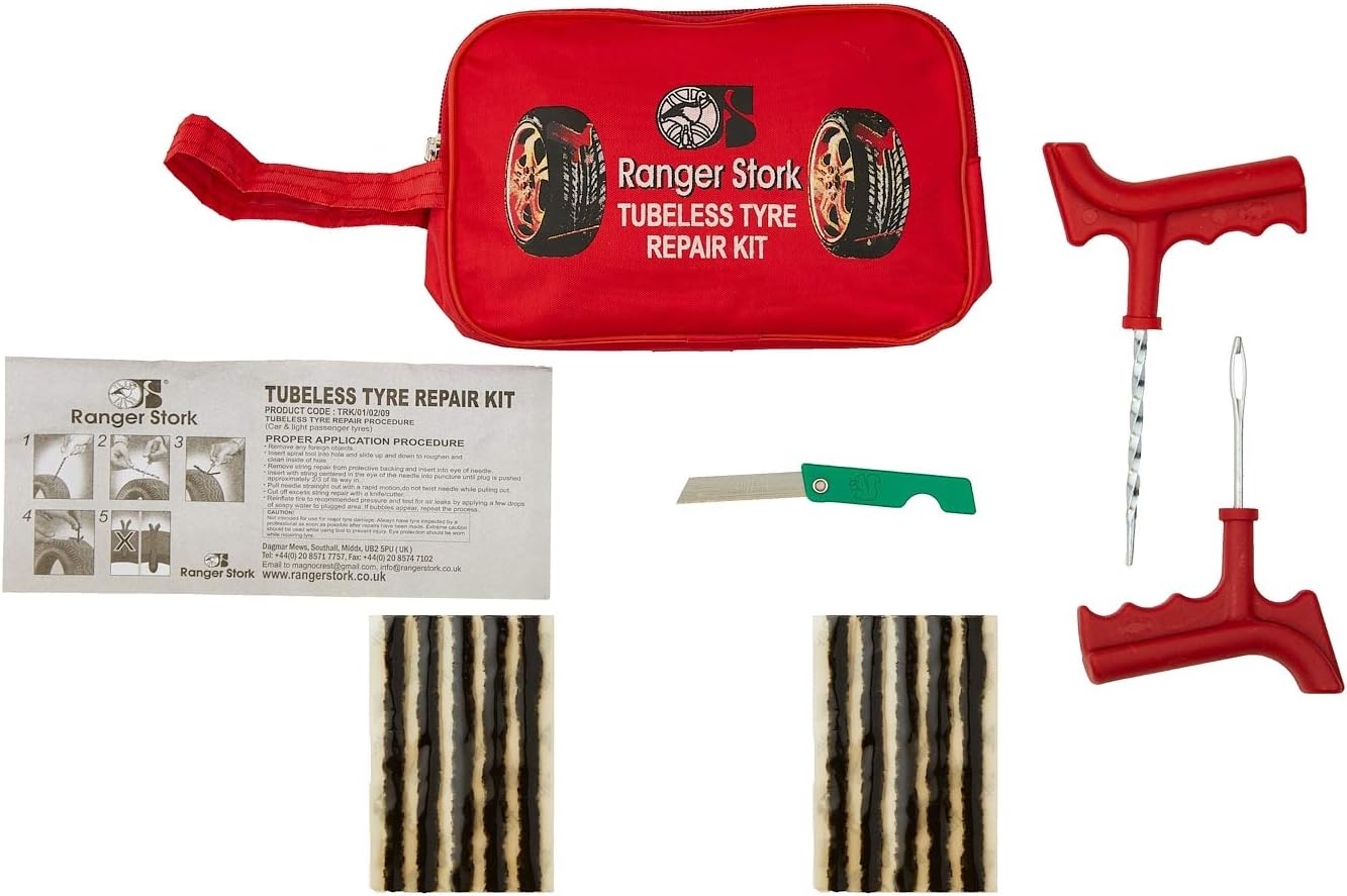

Some of the comments are a bit unfounded, it looks to me as if this is a brand new space saver tyre, and I think he's done a good job with this, OP says he is driving on rural roads NOT out in the desert, I live in Norfolk.... all rural roads. Also, remember he's still got his goo and compressor. He's only going to be 70 miles(ish) from a charge point, max. so not likely to be out in the outback. I congratulate him for identifying a personal issue and finding a good solution.
Incidentally, I carry one of these kits too. Maybe belt, braces AND a bit of string but they cost about a tenner, the size of a couple of fag packets and weigh nothing.
