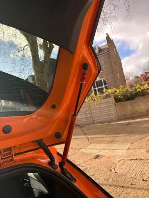

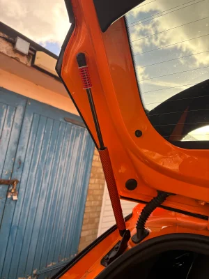

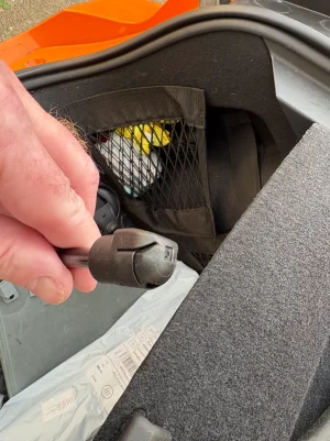

So I finally got round to changing mine today. As mentioned previously, it wasn’t particularly difficult to do, even on my own.
A few things I noticed that may help others:
  • When doing the first strut, I had to hold the boot up as the remaining old strut didn’t support it well enough. The second one was much easier, as the new strut is noticeably stronger.
  • Before starting, make sure the ends of the new strut line up with the ball joints. I had to twist mine slightly to get them aligned before popping them on.
  • When removing the clips from the old struts, take off both the top and bottom clips before removing the strut. This makes it easier to hold the boot while fitting the new one.
  • You can slip the clips back onto the old struts for safekeeping. The easiest way is to line them up with the slots down the side of the strut ends (see photos).
  • As others have mentioned, the boot is a little harder to close afterwards. That may just be my imagination, but it does seem to soften slightly with use. Only time will tell.
Overall, I’m happy with them 🙂
Now I just need to find the time to do the bonnet ones.
