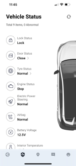

Exactly the same as mine. Anything between 12.2 - 12.7V.
Just checked it twice a few minutes apart & first it was 12.3V, then 12.5

As I have posted elsewhere the main battery will charge the 12V battery without the car being in ready mode or charging.
Here is a screenshot showing mine being charged. The car hasn't been unlocked or put on charge for over 48 hours.
