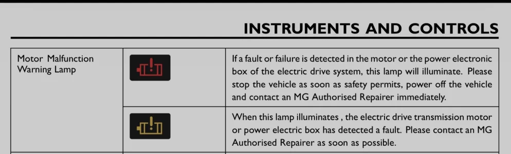

Hello, I started getting an error message that limits the performance of the electric motor. Unfortunately, I don't have a photo of this error message, which appears on a small display, because it only appears for 2-3 seconds and then disappears, along with the red battery warning icon. This has happened to me twice now. I don't remember what it said because it's in a foreign language. Has this happened to anyone else? Thank you for your help.

The icon always disappears immediately with an error message. But the engine performance was still limited. It didn't matter whether I set the driving mode to ECO or SPORT. At the time of the error message, the vehicle had 37% battery power.
Perhaps it was this message: Engine Fault – consult handbook. Hopefully, I'll be able to take a photo of it sometime so I can show it to the MG service center. The model is a 64kWh Luxury 2022.
