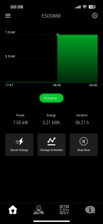

Bit of an odd one that’s just started - scheduled charging (via EVSE) doesn't start. It’s worked for the last month or so since swapping to BG tariff but doesn’t now until I go into MG app and select start charging?
Any ideas? This is the message you get normally once the battery is fully charged (incl. balancing). Only things that have changed are the smart meter has been changed and the ring that has power line adapter on has changed if that may have any bearing but it’s always been on in the house.

Well set to charge as before but killed the power line plugs off before plugging car in and voila functioning as it should. Proof enough for me.
It appears TP link power line adapters along with MG4 and VChrgd7 do not work well together, not sure which bit is affected and seems like having the Earth missing before prevented the issue but obviously that is NOT a safe configuration. Off to Amazon to buy some cat6 and hard wire.
