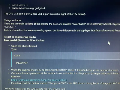

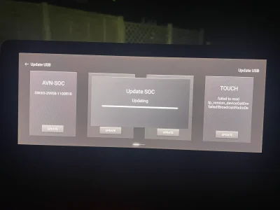

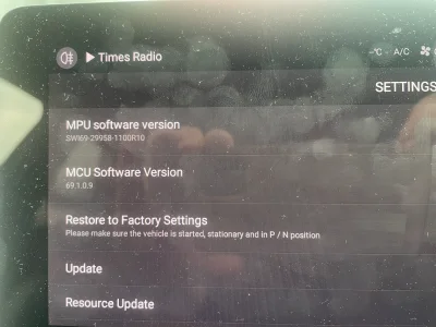

If you don't mind the small risk you can update the mpu yourself for free, latest is is R40That was my experience at its 3rd 45,000 mile service last week. The service campaign is only for the LKA, so we still have the SW169-29958-1100R10 for the MPU software. If we wanted this updated, it was £199- For us everything is fine (as before, even if LKA defaults to ON every time now - but its a completly different implementation now, and doesn't try to kill me for no reason now ) - the other challenge was the inside temp calibration (24 is about right for us), and sometimes we couldn't get carplay to switch on via wire, which was solved by a £30 wireless dongle. So it will stay at R10 unless its free, which is fine.

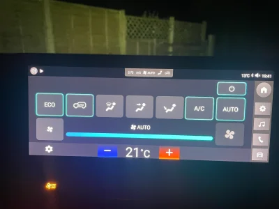

How is your HVAC working? Has the temperature control scale changed? (i.e. I now set my target to 21°C ... previously, before R38 and an HVAC module update, I had to set it to 24°C to have any chance of a comfortable cabin. Seemingly 24 was around the mid-point of the scale, but now 21 is).
Heating not cooling!My AC is always set to 'auto' and target temp of 22C, works very well, blower starts strongly for a while during hot summer days until it gets down to the target temp then very quiet while it maintains that temp.
Heating is exactly the same for me although I rarely use that here. Works just fine.Heating not cooling!

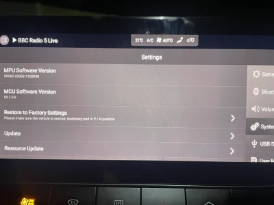

Is there a way to check if the module is on the correct version number? Mine is fine around town and slower roads (up to 50mph). However, as soon as you're going 70mph for 20mins or so (in my car) the heating is no longer steady. This could be the module has not been updated, even though I asked for this to be performed.As I've said several times (I have a '22 SE SR running 1100R38 plus the HVAC module update) ... I set mine to 21°C and Auto, and it all works fine - heating and cooling. In the (almost) past year (11 months to be precise, so all the typical UK weather conditions) I've never needed to adjust it.
Under Settings -> then system.Is there a way to check if the module is on the correct version number?

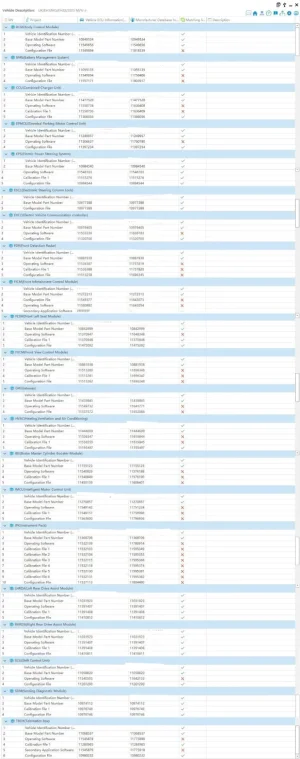

Unfortunately you need a car interface & software called SIPS which is dealership software to see the module versionsIs there a way to check if the module is on the correct version number?
Cheers. Ready for a service this month so will ask them to check.Unfortunately you need a car interface & software called SIPS which is dealership software to see the module versions
Some people have managed to get a print out of the software versions, you could request a copyCheers. Ready for a service this month so will ask them to check.
