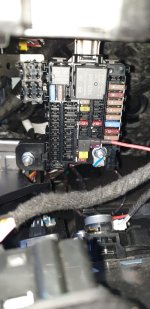

I know I am possibly a pioneer here but I have fitted my own witter tow bar, which went better than expected, but I am struggling with the electrics, I think I am right in saying everyone with a tow bar has had it professionally fitted, please put me right if you have fitted your own. It said in the literature that a zr2500 relay was required so I ordered one and attempted the wiring. but the biggest problem is it requires a 12volt supply at the rear of the car that powers down when car is locked and shut down. so my only solution is running a cable from the fuse box the length of the car somehow, as I cant find a suitable supply at the rear. I also need to find which fuse to use in the fuse box that powers down when locked. and does not affect any other circuits. any thoughts would be welcomed. many thanks. Dave.
As this might be useful for others, here are a picture of where my dealership choose to take the 12V power to the relay kit (passenger compartment fusebox and 90 degree power out take). Also have a look at my post #20 in this thread as it have a link to a post that might be of interest.
Be aware my car is a MY22.
