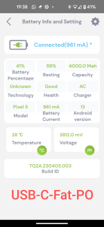

Port #2 - USB-C can only be used for power or possibly data transfer which I didn't test. Only one out of the three cables I tried would charge the phone and they all work in other 13amp chargers. Interestingly Ampere detected the port and the text "Disconnected" changed to blue but only one of the three cables made it change to "Charging". The successful cable is a display-certified USB-C so may have more wires as it's much thicker than my others. The lack of AA/CP is also mentioned in the car's onboard manual. With the thick cable, I was able to draw the same 961 mA.

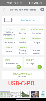

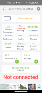

Hmm, I've tried three different cables that all work to connect to other computer devices and chargers.
Does the Disconnected text change from orange to blue with any of the cables? See difference between images #2 and #3 below.
Three images are below.
1: USB-C-Fat-PO - My AV rated USB-C cable connected to port 2
2: USB-C-PO - Stock Pixel USB-C connected to port 2
3: Not Connected - USB-C cable in phone only
