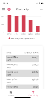

I do agree its not worth it, as its cheap taking power from the grid overnight far outweights any local / home owner intervention (I think my december 22 bill, nearly taking 1GW - was around £90 incl. standing charge), ive just looked on the smart meter display:- Total this year = 3082Kwh which has cost £289 (incl. standing charge at nearlty 50p / day), which is way less than 10p / unit (so if we assume 6 months, then the standing charge is £150, and the usage is £150, i.e. 5p / unit (with EDF))
