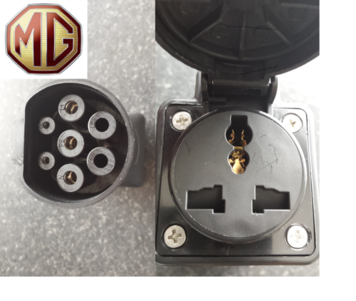

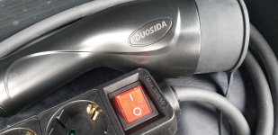

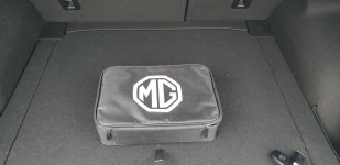

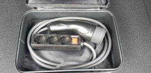

Here are my original (schuco) MG V2L adapter (Duosida).
Look nice. 👍
Here are my original MG V2L adapter (Duosida).
