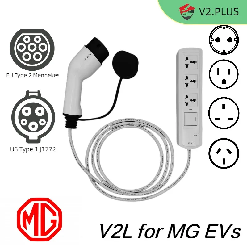

Aussi55, Here is the link to the cable I got from Ebay, it worked for 6 weeks!
MG EV V2L cable
Could there have been a software update sent to the car or can that only be done in a MG garage?
Sorry to hear that. I bought mine from:
and it worked OK so far. I ran a 1200w microwave + air-fryer + fridge simultaneously for about a half hour and all worked without issue. Though I won't overdo it. I've achieved my goal to have fridge backup if the power goes out.
The only nagging issue is that the driving lights remain ON the whole time I'm doing V2L. very annoying.
