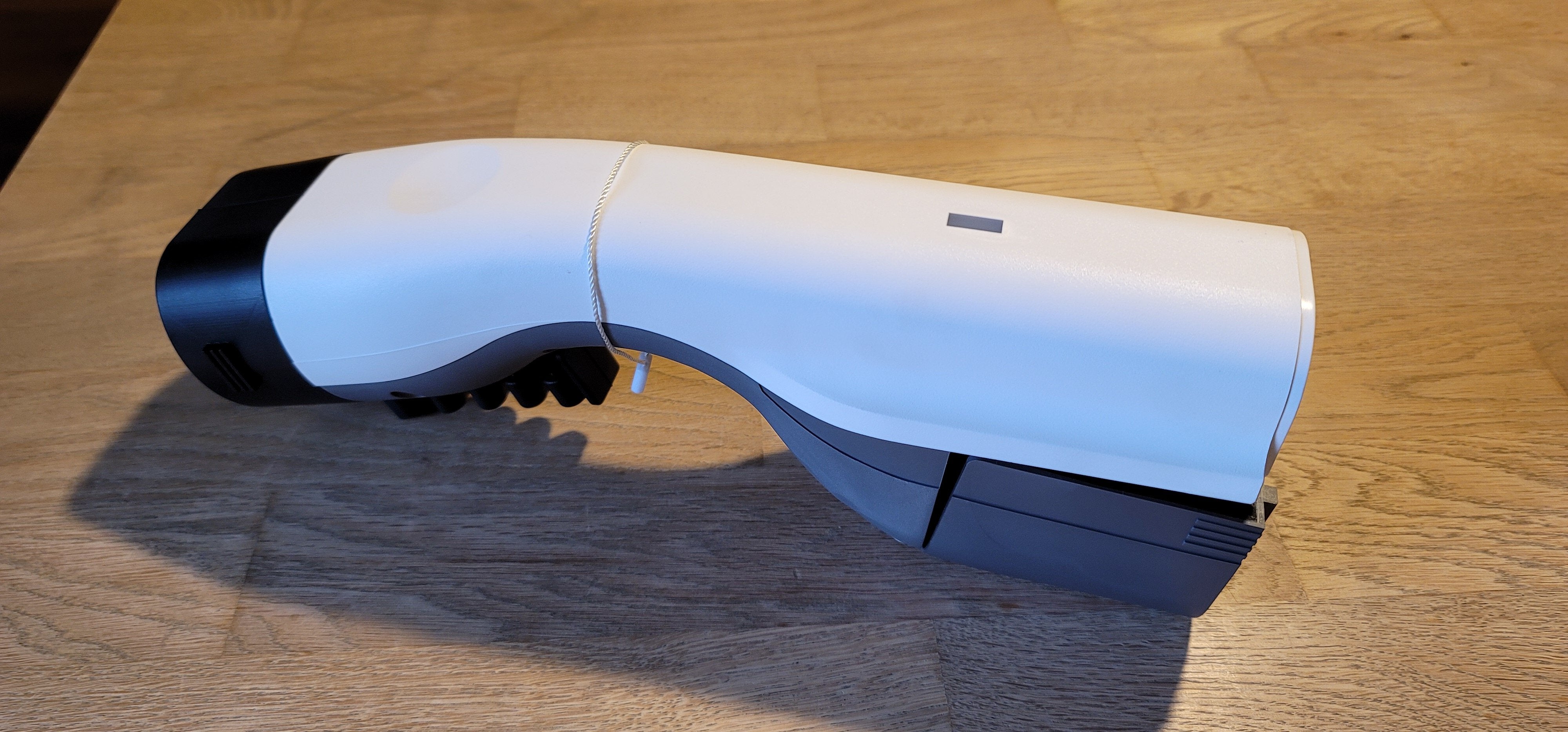

And for those who are interested and want to know the inner workings of the Type 2 plug for V2L, this post shows the Hyundai adapter being broken down and what's inside.
Perhaps this will help someone who know a little more about electronics than I do to make their own V2L adapter using this info?
From the photograph, the lead looks to be no more than the type 2 plug on one end and domestic sockets on the other. Is that true?
Correct,
Correct, the cable just attaches to the car's charge port. There is a little bit of electronics in the type 2 to tell the car it's attached, but nothing spectacular or that warrants the outrageous prices being asked.
The prices for the V2L adaptors are ridiculous!!! It’s just a shell with a few wires, a thermal fuse and a switch.
All the clever stuff is already in the car.
