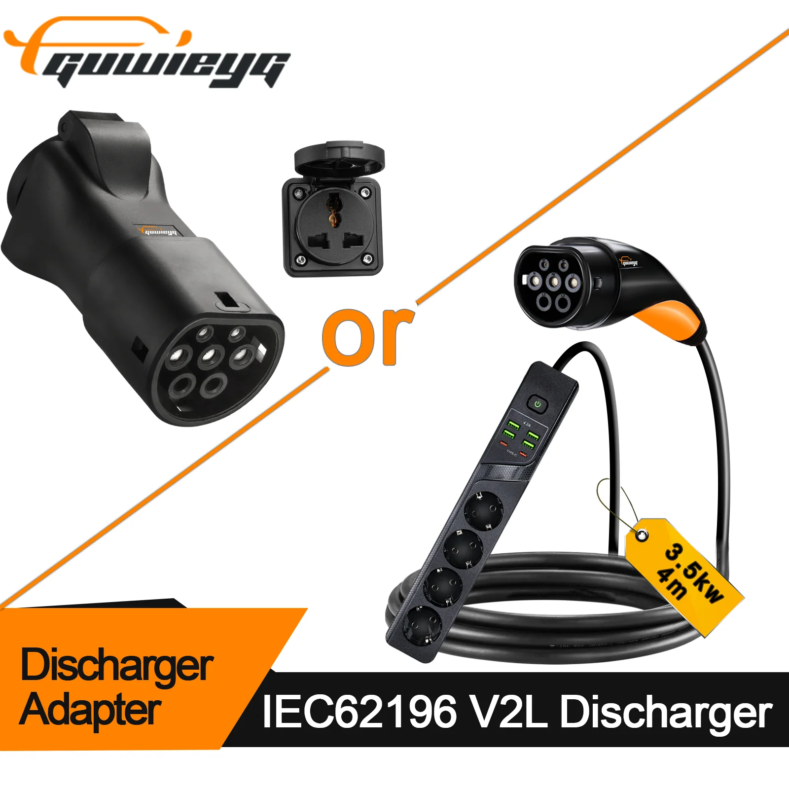

Hi all,
Just see this on the other side of the world :
30€ all inclusive for a compact V2L adapter configured for MG EV cars.
No need to make the job ourself, now.
PS : for other EV brand's friends, they also make for KIA & co at the same price !

I have bought a similar product for the MG zs. I have read on the forum that the resistance required for it to work is a 470 ohm between the pp and pe lines... ie pp to earth. The resistance measured on the one I received is 1kohm. I haven't tested it yet but suspect it will not be recognised so I intend to swap out the resistor to 470phms.
These are sold as working on the MG but I doubt it if there is a 1k ohm resistor fitted.
Has anyone bought one that works without any modification?

I know: I'm one of the first to previously buy blue adapters with 1 k·ohm resistor at the wrong pins. In fact, they were not discharge adapters for MG EVs, but some other kind of adapter to have power from a stale charger. We just abused these with modifications to use on our cars :)
The ones on the link I provided at last seems to be real discharge adapters with good values for our cars. Buyers comments indicate that they work.
So it could be the great & cheap solution to have a functional adapter without making any modifications.
If this is not true, it should always be possible to correct the resistor inside.
A call for everyone : 470 ohm resistor must not be used anymore ! This a test & run value that proved to work but with no current limit (so 6KW and over !). This is not good for a normal cable.
We have to use 2 k·ohm resistor instead to limit current to something about 3 kW.
