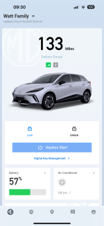

Just done the commute, in Normal mode, high regen achieved 3.1miles/kwh trip was 18.1 miles, left with 133 range 57%, returned with 48% 103 miles on the range is this normal if so I will just have to get used to it, maybe this car performance is better in summer as I got the car in winter maybe is not that good in winter/cold weather

Bear in mind that range estimate in the app equates to Normal mode/no HVAC or Eco mode/with HVAC. (They approximate to the same thing). The in-car picture shows Normal mode - was HVAC turned on?
