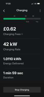

Got the software update from dealer in Bideford (after a bit of humming and hawing) -paid them £90.
Confirmed Tesla charging works now, on Bristol chargers by Ikea yesterday.

Got over to Earley (Wokingham) site yesterday evening and, following updates I did over the weekend, have confirmed the car now accepts/works with Tesla chargers ok. Only managed charging rate of 35kW though but put that down to the site being completely stacked-out.
