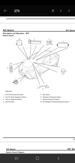

It's air temperature sensor
Seems an odd place to be, out in the air flow?
They are usually tucked away behind the bumper or in the gap above the wheel arch liner.
Might be why some folk have such a large discrepancy between interior and exterior temps on the app?

My wild guess: it wants to sample the outside air temperature, to compare with bonnet air temperature, to see if opening the grill will make it hotter or colder. Hence its position in the air stream.
Edit: Slightly confirmed by the story of the flaps opening and closing with the hot air blast.
