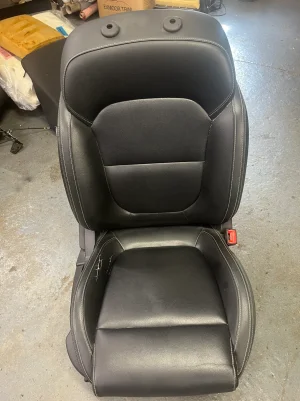

I’m currently going through the process making a formal claim against MG as they won’t entertain repairing or replacing my driver’s seat cushion on my ZS EV which is suffering from degradation on the offside. I have been asked to submit an independent report with costings for remediation. I was unsurprised to see another MG driver’s seat with identical faults caused by the substandard materials sat in the workshop of the specialist repairer. The upholsterer said I’ve repaired lots of these as it’s a very common fault with MG’s! See photograph of this seat already in the workshop.
That looks like he seat from the original Gen1 ZS EV as the Gen 2 has the “carbon effect” pleather material, same problem on both models regardless.
But the Gen 1 should look a better job, as it’s an easier match of a plain material.
It would be very interesting to know what he used to replace the damage, did he just replace the bolsters or make a complete new swab ?.
What material did he use - leather ?.
The cost of the repair would also be handy.
The fact that he has done “loads” tells you all you need to know really.
It should tell the manufacturer the same message also, you have a problem with the material on your seats are clearly NOT fit for purpose as well.

Hi Lovemyev,
Here’s a copy and paste from the quotation I received for the seat repair:-
1. MG- LX20 MX:
Driver seat base bolster (left side of the seat base – in/out section).
The cover is made of Vinyl that start to crack along the entire length of the bolster.
Problems like this usually occur due to poor quality material and the high temperatures in the car.
2. The seat can be repaired by removing it from the car, removing the upholstery from the cushion,
ripping out the damaged bolster, sewing in a new one, fitting back the seat into the car.
3. Replacing the bolster costs £350.00 plus VAT = £420.00 Total (including labour and parts)
This job will take 6h to be completed.
If you need any further information please let us know.
Kind Regards
Tomasz Gossa
Tiggy Design Ltd

Thanks for posting back !.
What was the complete new bolster cover made from ?.
Did he use vinyl or leather ?.
