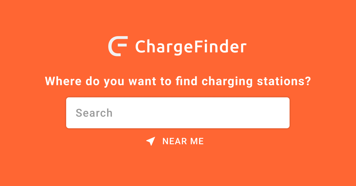

The DC Rapid charger on the other hand is controlled by the charger. These come in a big range of power, anything from 50kW to 350kW.
There are lots of aps you can get for your phone that tell you where these chargers are, or you could just google them.
It looks like you have a 50kW one close buy
