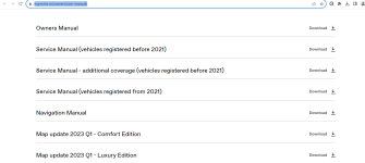

Owned my ZS EV MKII Long Range 2022 Trophy Connect since May22 and not yet updated maps but just found after reading all the posts this is the way to get to the Q1 2023 MG Maps. Go to URL User manuals and enter in your VIN number from the windscreen of your car and hey presto !!!
Says 2023 Q1 update if I follow the link.
