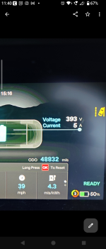

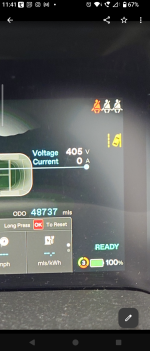

If higher voltage like yours is to show anything, yours seems better than most others so nothing to worry about...
Regarding your photos: the second one has load on the battery, 5A, that would have dropped the voltage. Also: surface charge will come off quite quickly. So really depends on how soon after the end of a 100% charge one looks.
As to worry: not sure that is the right conclusion, maybe I need to worry less than others, but maybe they should worry more.

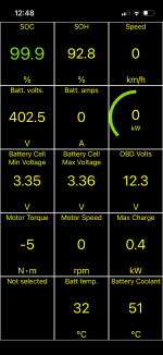

The inverter showing ZS balancing. Looks like 20 mins and it tails rapidly
Compare that to the home battery that has resistive balancing. Balance take far longer
