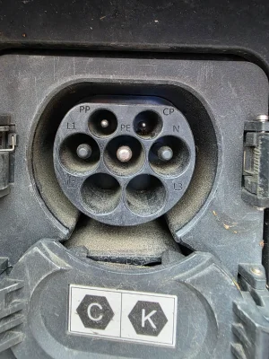

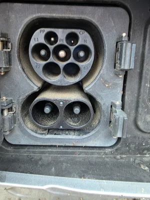

Issue with corrosion or some fault in the charge port?
It doesn't look corroded and I've just tried again, still no joy - disconnected the battery for 10 minutes and tried holding the charger whilst in to see if that helped!
There does seem to be some crud in the top right pin hole there, the one marked CP. This is the main communication wire and if it's not making a good connection...
