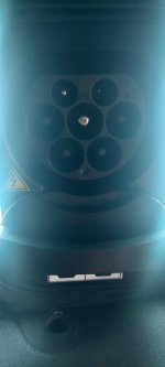

I am not sure but I think your car only has a single phase 7kW charging. If plugged into a 11kW three phase charger then 3kW is about right. Take a photo of your charging socket and post. The way to tell if your car has three phase charging is if all the holes in the cars charging socket have pins in them.

Wow! Thank you Nicko. I took a photo of the charging socket and can see that only L1 has pin. L2 and L3 are empty. So I'm only getting one phase of the three coming out of the charger. I'll talk to the dealer tomorrow and see where I can take it from here. Maybe they can swap me over to a single phase 7kW Charge Hub, I wonder if that would give me a bit more output. We have an Essence 64, maybe 3 phase is only on the Trophy.

I havnt seen in any of the post above which model vehicle you have. Here in Australia, I have the LR 77kw essence (trophy). It has the extra pins and I have the 11kw charger on 3 phase. It is capable of 10kw. As others have suggested it is likely that you have the 64kw NMC battery and that is limited on the AC to single phase and you have the incorrect charger. I will try to add some pics of socket pins and charge rate.
