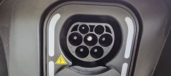

I got a Cyberster GT dual motor,
in the sales brochures it said 11 kW on board AC charging.
I can not find any information in the given manuals.
I have a 3 Phase house and bought the MG 11 kW charger to get 3x16 amp.
However, I am not sure anymore if the car has 3phase 11 kW onboard. It would be meaningless to install the 11 kw charger as I would get 3.6 kW only anyway.
Attached a picture of my charging port, can anyone identify if this is 11 kW pins or 7 kW pins?
in the sales brochures it said 11 kw on board ac charging.
I can not find any information in the given manuels.
I have a 3 Phase house and bought the MG 11 kw charger to get 3x16 Amp.
However, I am not sure anymore if the car has 3phase 11 KW onboard. It would be meaningless to install the 11 kw charger as I would get 3.6 kw only anyway.
Attached a picture of my charging port, can anyone identify if this is 11 kw pins or 7 kw pins?
It has the L2 and L3 pins in the picture so should be the 11kW onboard charger
Look at post 4 on this thread which shows them absent on a 7kW version
Only getting 3kW from an 11-22kW charger when the specs for your car say it can accept 11-22kW is because you're using a 7kW 1-phase cable instead of a 22kW 3-phase cable.
Thank you guys, all clear now, than I have the 11 kW on board and will install my wallbox soon.
