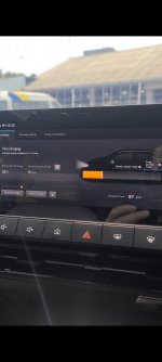

Went to 180kw charger station...
Disappointed as I only get up to 87kwh charging speed...
Dammit mg stop giving false advertising

This is an issue of early advertising by MG of a charging speed for the SR that was never achieved by the car as sold. In an earlier thread someone suggested that the 117 Kw figure was an aspiration by the design engineers, but it never made it into the production model. Later published specs have amended this to 88 Kw, which seems realistic, and a few people have reported getting around 90 Kw. (The best I've noticed on mine is 85 Kw.)
Here is a charging graph for the SR, it's the red line that doesn't jump around.
In fact I have seen it reported that overall charging time as the car actually exists is just as good as might have been achieved with the 117 Kw figure, because that would probably have been maintained for only a short time. The 88 Kw (or whatever) is maintained for a decent length of time and the car goes on charging pretty well as the SoC increases, giving a pretty decent total charge time on an ultra-rapid.

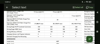

Latest information from MG now states max charge of 87Kw for the SE SR (can't find it now...)
Edit - found it on the Australian website
