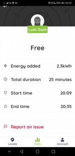

I did not charge my car since BMS update on 25/01/2021, because I had full battery. I plugged in yesterday at Pod point 22kw charger, cable was plugged in but was not charging, until I locked the car. Charging did continue when open the lock. Battery charge was 70% and in 26 minutes only got 2.3 KWh added, when the temperature was 9. I thought it should have given more charge for 22KWH charger? Previous charge before battery update, I would get near enough 7kwh for an hr charge at 7KWH even even when the temp was 1.

The ZS only has a 6.6kw onboard charger so unless it's rapid charging it will only ever charge at that speed no matter if it's a 7, 11 or 22KW charging post
