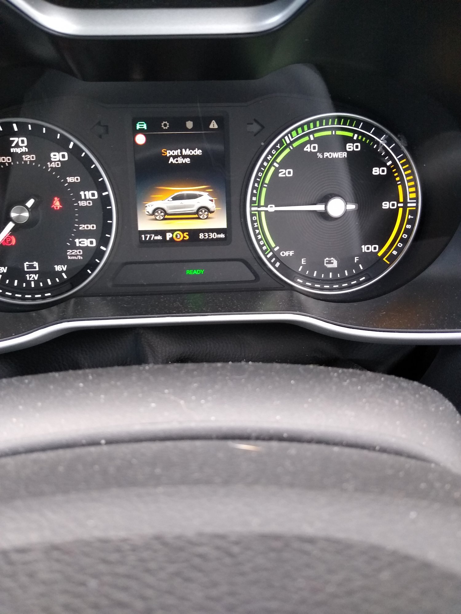

I've just taken it off charge and the pic below shows the Voltage and range:
I never had problems with the BMS, I was getting 457v and 179mi Eco/163mi Normal, after new BMS update I got 450v and the same 179mi Eco/163mi Normal, so I wouldn't be worried about voltage because range is what matters.
I never had problems with the BMS, I was getting 457v and 163mi Eco/179mi Normal, after new BMS update I got 450v and the same 163mi Eco/179mi Normal, so I wouldn't be worried about voltage because range is what matters.

Just for info.
Taken this morning, no BMS update.
