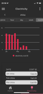

They good news is that you appear to be on a winter setting, so you can try things out over the winter. Most folk have a summer & winter setting - in our case its a simple hardware fix (of moving a CT clamp from one mains in wire to another ) - but I'm sure we can all help each other out to help optimise ones system (y)

The setting was certainly right for the way I was placed at the start, with any export being a complete waste. At that point I wanted to use every bloody sunbeam I could. But the installer didn't say anything about changing it once the export tariff came through.
I could envisage using what you would call a summer setting all year, if the 9.5 kwh battery was capable of covering the entire house load even in winter, and exporting whatever meagre solar was there. It seems I'm not going to get the chance though, as things stand.
I'm still struggling with the CT clamp thing, but if you could explain maybe I would be able to follow you.
