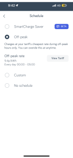

A NOT SO short update on our British Gas Hive EV charger installation.
It gets better (if that is possible), the HIVE changer is charging my ZS this evening at 18:30 when scheduled for off-peak 00;00-05:00 and no schedule set in the car. !

I have just put the plug back in the charger. Removed schedule, I’d previous set from both iSmart and the ZS, they don’t sync too well.
Tripped the supply on the charger and waited.

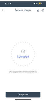

Removed the Hive app from my iPhone, rebooted the phone and reinstated the Hive app.
Plugged in the car and locked it. Hive app is now showing scheduled, as below. We shall see what has happened tomorrow morning. ?.
A refund or court action at this moment will not solve my home charging issues, but it may come to that.
But for now we wait and ?.

Scheduling on the Hive just got overridden, not immediately, so I think it’s something to do with the SmartCharge Saver coding.
Set scheduling in the ZS and will see what happens.
