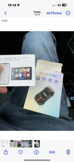

Funnily enough weve just set this one up in my Wifes MG4 Trophy & it’s playing her music whilst directing us to Peter Kay on the M6. Cost £13.00 off Ali express which is under £20 after UK tax. Took 10 days to arrive.

I purchased an Apple CarPlay dongle from Temu for around $50 Australian, it only works by plugging and unplugging or rebooting the dongle by purchasing a USB cable with a on off switch.
It looks like the majority of these CarPlay adapters for MG 4 are problematic.
Go to the settings page using the web address in the instructions. Update the dongle (whilst sat in the car) then increase the delay start option from 0 seconds to 60 seconds. It cured mine (thanks to another members advice) no switching/reboot needed. It will automatically start inside approx 90 seconds of starting the car.
