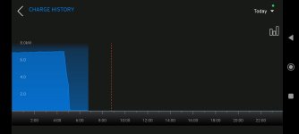

I know with my SR that if I plug in at just before 8pm at less than 10% and ask to add 100% by 4am it will give me one continuous slot. Then at just after 11.30pm I hit bump charge to ensure that Octopus don't override or change any of the allocated slots.
Attached is last night's charge when it started the balance charge just after 5 am (the charge started later than normal).
