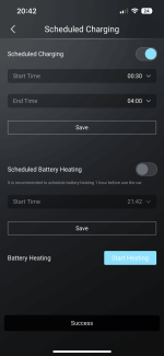

In the iSMART app I’m toggling on the scheduled charge, setting the time and tapping save. After entering security code I get a success message.
Logically I would assume that this now means the car won’t accept a charge outside of this time but that’s not happening.
The car time is set correctly.

I’ve started again, disconnected everything and resaved the car schedule and then finally reconnected the car. The cable is locked in the car charge port now and isn’t trying to charge so we’ll see if it kicks in at 0:30. It doesn’t help that there seems to be built in delays all over the place so you can’t test cause and effect very easily.
If it doesn’t work I’ll have another look through the car settings and toggle the gps one.
Nope, didn’t work. Just charged again starting at 22:05.
Also disabled gps time sync setting on car.
Something definitely not right then. It's almost as if schedule doesn't exist or it thinks charging can start at 04:30 and finish at 00:30 or the app is sending spurious signals. Weird. Given the delays as you state there is no easy way to replicate it. Have you forced stopped the app, leave it stopped and relied on just the car setting if it can be done....straw clutching
Might have made progress. The home charger has a “delay charging” setting that was set to 600 seconds (10 minutes does seem to be when it starts changing after connecting). I lowered that to 1 second (doesn’t accept 0 and I can’t see a way of disabling) and set it up again last night at about 11pm with a 90% target. By 23:30 it wasn’t charging so I went to bed.
This morning it’s at 90% so hopefully that means it started at 00:30. I can’t check though because the home charger doesn’t have a record of the charge. That could be a bug with charger if charge is requested from car in this mode. Will email charger manufacturer. I might be able to check from electricity supplier app (octopus) but that info doesn’t appear for at least 24 hours and I also think it’s reporting an hour out anyway.
So my current thinking is when the delay was set to 600 seconds, after I connect the cable no charge happens because of the car schedule and also the delay (but a handshake does occur). Then after the 600 second delay is up the home charger kicks in and the car thinks “oh they must really want a manual charge” or “this is a smart charger that has its own schedule” and it overrides the car schedule. By setting delay to 1 second maybe that delayed communication at 600 seconds isn’t happening and the car sits happily until its own schedule kicks in.

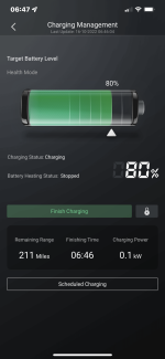

I have the same Wallbox plus, charge my MG4 for the first time last night, scheduled to start 00:30 in car, for reasons unknown my phone was still preset at 22:00 start finished 06:00, so I also set my phone to start 00:30 and finished at “charging to target battery level”. And inputted my password and saved the setting.
Long story short, I woke up this morning around 6am, app indicated 78%, showing finishing time 6:20( not sure exact time?)
I opened the MG app at around 6:30, it has already charged to my set level 80% but it was still charging at 0.1kw, in fact it didn’t stop until around 07:42? before I got notification from my Wallbox charger that the charge was completed.
Then I noticed my phone app schedule has defaulted back to factory setting of start time 22:00 and finished time 06:00.
Did I somehow missed a step for setting this schedule charging up? And why 0.1kw, anyone else noticed that as well?

The period of low charging could be the bms balancing the battery.
Update. Did everything the same as last night and it’s still wanting to charge now after a short delay outside of the set schedule.
Do you have a granny charger to try it on? Eliminating the home fast charger charger would be a useful diagnostic check in my view.
Is it possible to balance the batteries at 80% charge? I always thought it has to be fully charged at 100%.
Depends on the bms, quick google and tesla is said to balance any charge that is over 90% the zoe needs 100% for a balance, it will sit at 99% for between half an hour to 2 hours doing a gentle charge, hence why i would think the mg4 is balancing the battery during the same behavior.
I’ll see if it still does it on my next charge, but the car is brand new and only did 40 miles ?
Mind you, my Tesla app does not show KW in decimal place, it probably did it without me noticing?
