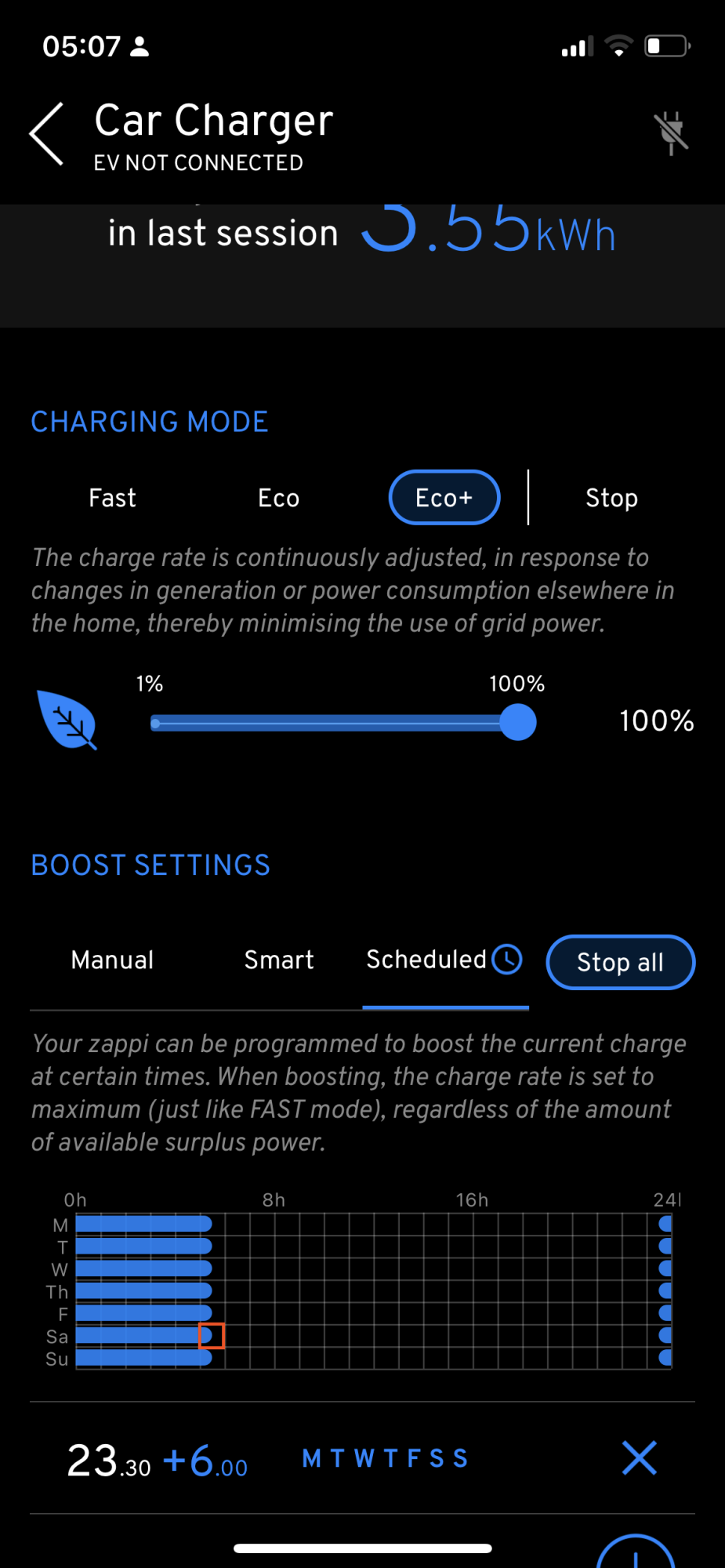

Somebody please tell me why my Zappi insists on starting to charge my EV at midnight at full power, even if it's been left on eco+ waiting for morning!
I think it's something to do with the MyEnergi app I installed thinking I'm on Octopus Go, which has a cheap rate starting at midnight, and that it has to charge the car from this. But I have no idea how to stop it.
Are you on GO or Intelligent Octopus GO? Any schedules setup in the Zappi (look in the app), click on the Zappi and then scheduled.
I am on Intelligent Go, but the MyEnergi app doesn't have that as an option. It seems to think I'm on Go, and I can see no way to alter this. Anything else I try to put in, it switches back to Go.
I just want Zappi to butt out of trying to charge the car from the mains. I either want the Zappi to charge it from excess solar (which it does very well), or to let Octopus do its thing with scheduled charging. But if the car is plugged in at midnight, off it goes!
MyEnergi APP doesn't control Zappi when youre on Intelligent, Octopus do. Make sure there isn't a schedule set in the APP under ECO+. The only other thing it could be is if your battery / inverter exports more than 1.4 kW at midnight for whatever reason it can kickstart the Zappi into charging when in ECO+, you could also check the delays that are in the Zappi.
First problem is that there is no option to select Octopus Intelligent Go in the app. I've tried selecting different things (like "other") to see if I could clear it completely, but when I navigate away from the page and back to it, it has reverted to Octopus Go.
Charging is set to eco+. But, you know, I think you've cracked it. I came across a screen I had not seen before which set a scheduled boost Monday to Friday from midnight to (I think) 8am. God alone knows where that came from, I certainly didn't do it. I don't even remember if it was on scheduled boost at the time - it seems to change its settings as it likes. But I deleted that schedule so hopefully it will not do that again.
There is a "stop all" setting, but that's greyed out, and the one time I did manage to select it, it deselected itself when I navigated back to the page. There are also settings foe "manual" and "smart" but I don't know what they do. Might it be best to leave it on "manual" to avoid the Zappi trying to do anything on its own accord? I just want it to scoop up the sunshine when the car is connected, and let Octopus do its thing if I set an overnight schedule in Octopus. (I did that once and it worked.)
Could have been worse. I saw what was going on in time to stop it before it had drained the battery, and at least the fact that it was taking power from the battery meant that the mains draw was only two thirds of what it would otherwise have been! Load of wasted sunshine today again with nowhere to put it though!
I'm not sure which APP youre referring to here, MyEnergi, Octopus or your Inverter / Battery APP?
In the Octopus APP you should find 'Devices' in the middle at the bottom of the screen. In there you find your charging details, how much energy you want to add to the car by what time. When thats completed, plugging your car in should result in a schedule being sent to your phone and Zappi started at the appropriate time.
Yep, no schedules needed for Intelligent.

Stop All is under boost settings in the MyEnergi APP. It's greyed out when boost isnt in operation.
That again is boost settings, just leave all the boost off and let Intelligent handle it all.
Noooooooo
If you simply set ready by 05:30 and the amount of charge you would like adding eg 50% or 100% etc, Octopus will charge it overnight. If you dont set a % / time, ECO+ will initiate a charge with surplus energy.

I'm referring to the MyEnergi app. That's the one that seems to be causing the trouble, and the one which had the hidden schedule I hope I have now nixed. That asks for your supplier and tariff, but it doesn't have Octopus Intelligent Go on its menu.
Boost seems to be the issue. I don't want any part of it, but I don't know what to set it at so it doesn't try anything. Obviously not "manual" from your response!
I only asked Octopus for a scheduled charge once, and it did it just fine. I've asked the Zappi to use surplus sunshine and it's done that just fine too. (Except if the sun goes in while the car is balancing, it won't resume balancing when the sun comes back out.) I think I've seen the charge cut out while there was a hailstorm then cut back in when the sun came back out, which is encouraging.
The only issue has been that Zappi would start pouring charge into the car from all sources at midnight if it was plugged in then, and I think nixing the schedule should sort that.

That wont work, if Octopus sees Zappi charging the car it will issue a schedule and take control. You have to switch off smart charging the the Octopus MAP. Theres no need though, Intelligent works really well with Zappi.
