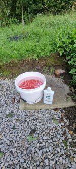

Hello,
First post here so thought I'd make it a helpful one! Cleaning Matte Green Paint.
I have been polishing my cars for as long as I can remember (old git) so was looking forward to my very recent purchase with matte paint as it should be much easier to look after. This is my second wash and is indeed very easy to keep.
Jetwash off the worst of the dirt, followed by a 10 minute soak in snowfoam.
Jetwash that off, then a lukewarm handwash with Autoglym Shampoo and conditioner. Then final rinse.
I use my leaf blower for the worst of the water followed by a microfibre towel to finish.

Using a car shampoo such as you have will soon likely add a sheen to the matte paint. There are products out there specifically for matte finishes. Suggest you do a search for how to look after a matte paint. Hope you dont mind me saying.

My research was not thorough enough I see! I know I can't polish the paint but read that I could use the autoglym stuff without issue. And of course I don't mind you saying, we are all on forums to live, learn and share. 👍
Like the car, got a white one on order for Dec/Jan delivery
Autoglym do a shampoo specifically for matte paint so I'm going to use this and snowfoam.
Here's the link for details: Cupra and AutoGlym team up with matte paint care guide - Auto Repair Focus

Thanks to Tycho....
To protect the paintwork, Autoglym recommends its Rapid Aqua Wax. This liquid-based wax will thinly coat the peaks and valleys of the matte paint surface, rather than fill them in like a thick paste wax would. Simply spray the wax onto the surface whilst still wet, use the supplied microfibre cloth to spread it evenly across the surface, and the other microfibre cloth to dry and buff. Alternatively, Autoglym Rapid Ceramic Spray will provide a protective layer with UV protection and hydrophobicity to make future cleaning easier.
If any further detailing or correction is required, the use of any hard waxes or products containing abrasives such as polishes, compounds or scratch removers must not be used. Owners should contact their local dealer to rectify any scratches.
Lastly, for any annoying marks which remain such as greasy fingerprints, Autoglym Fast Glass is ideal as a spot cleaner on matte paint. It should be remembered that over time it will strip away any protective wax applied and so this should be reapplied after repeated use of Fast Glass.
“Motorists are often nervous of matte paint care finishes due to the notion of it being easy to damage, and whilst this is true, by following a few simple steps when washing the vehicle and by using the right products, it’s easy to prevent this from happening,”l
