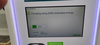

Hello. Today i took my mg4 51kwh to ultra super fast charger. Its rqted at 250kwh.
I plugged it in qt 58% soc.
But im only getting max at 63kwh speed. There was an ioniq 5 charging at the time too.
Im curious.
Isnt the 51kwh batt mg4 is rated at max 117kwh speed?
when 2 cars are sharing a charging station does the power output halved?
If so. Why am i not getting the max 117kwh speed as advertised. Mqybe someone knows the technicality?
Thank u

The 117 Kw raing was always a myth, it never did that. Speculation on the forum is that during development they thought they could achieve it, but never did. Later specs have a more realistic number quoted, possibly 85 Kw. There is video footage of people achieving 88 Kw on the SR, and I've seen 85 Kw on mine.
It will depend on your state of charge and the temperature too. You'll only get the maximum rate at a low state of charge, say under 50%, and when the battery is warm.
In fact the car charges reasonably fast, if not as fast as the LR. This is because it holds a fairly high rate of charge quite well up in the charging cycle, so you get a decent rate for a fairly long time. The original (fictitious) charging curve with the 117 Kw on it only achieved that for a very short time, and in fact the real charging time is probably as good as it would have been with that curve, overall.
Hi, there may well be a bit of power sharing and the quoted max could be for 800V the two car using it are both 400V.
If two cars were sharing 250 Kw then you'd still expect to get 125 Kw, all else being equal. However you will not get 125 Kw on the SR because it doesn't charge that fast. It doesn't charge at 117 Kw either despite some earlier literature claiming that it does.
Its maximum charging power is about 88 Kw. To get that you have to be at a low state of charge, and to have a warm battery. The photo in the OP shows a car visibly over 50% charge, maybe as much as 60%, and you are not going to get 88 Kw at that level. 62 Kw is about what I'd expect at that state of charge - I'd be hoping for 85 Kw or better down below 50%. Overall the charging time isn't bad though, because it maintains the 85-88 Kw peak for quite a long time, and as I said, 62 Kw isn't bad when you're up around 60% charge.
I found this graph of charging curves that includes the MG4 SR. It's the red line that doesn't jump up and down like a jack-in-the-box. You can see what charging power you can expect at various states of charge, with a warm battery.
yes this makes sense...i watched bjorn's video charging test.. he started at 10% and its above 80kwh...then when its charged until about 60% ( where i was) the kwh charging speed is identical to mine. i guess 117kwh speed is a myth. ... thanks guys for the replies.

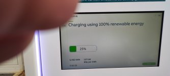

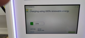

I don't think the charging speed quoted is a myth ,just you started at to high a battery state of charge and probably a cold battery the charge speed for the trophy battery certainly isn't a myth see pic
