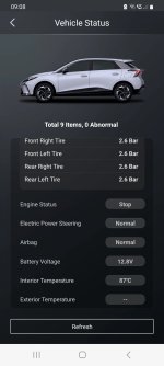

No. I had suggested a drain but I think the 5 software updates resolved the issue. Certainly showing a consistently stable voltage now, although internal temp report is way off. 85C earlier.
I took a screen shot - 87C
