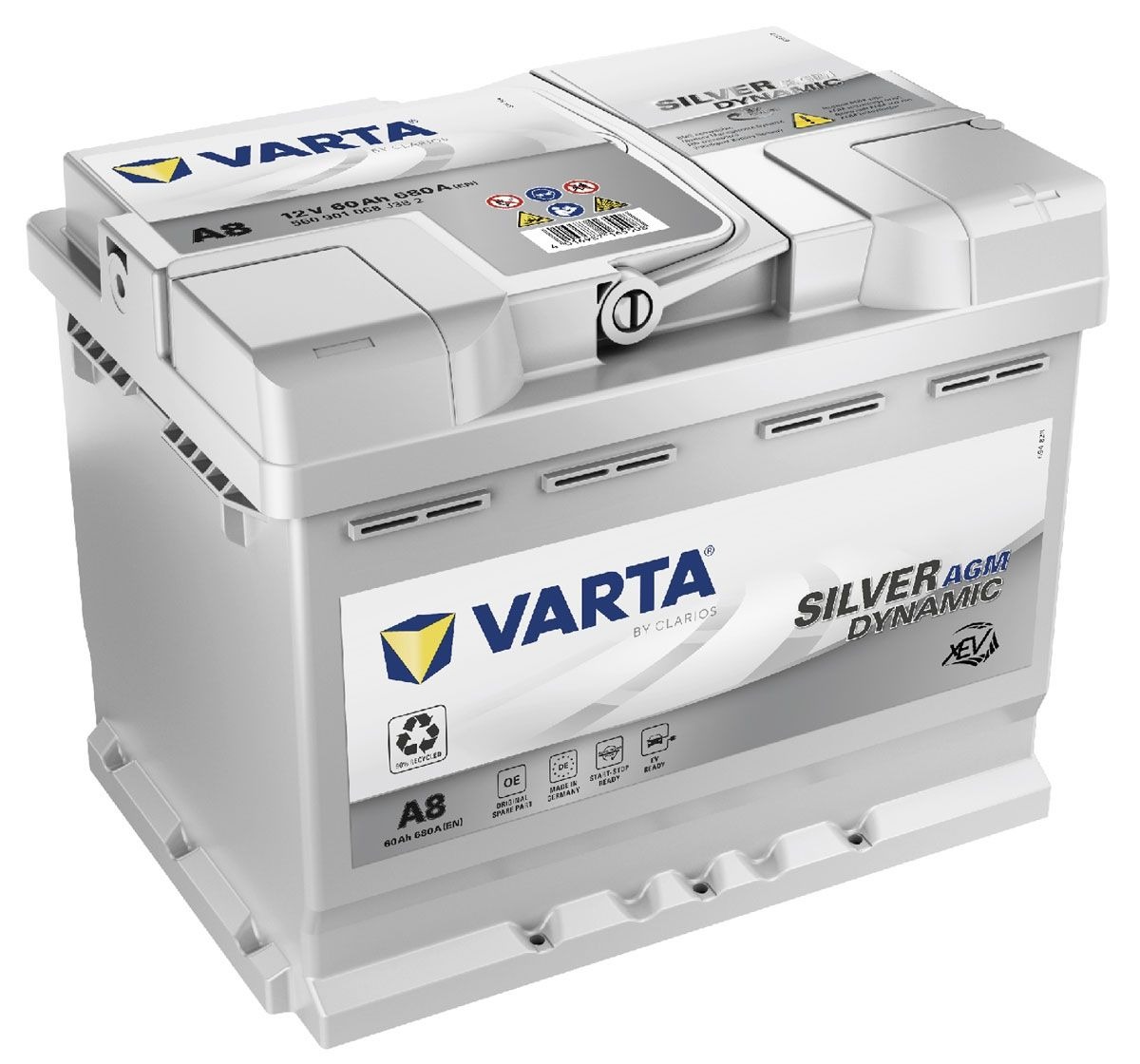

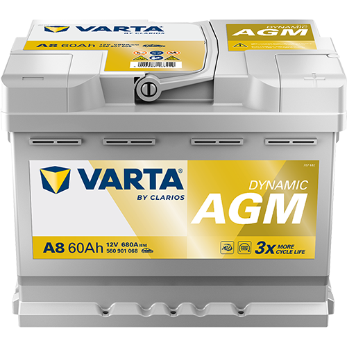

Do anyone know if that Varta battery will workbwith my M4?
