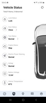

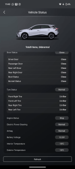

Just read this thread with interest. Looked at my MG. Internal temp 87°c, external 10°c. ?
Refreshed; 16°c / 10°c
Refreshed a few more times and gradually got to 10°c / 10°c. (I think it went 14, 12, 11, 11, 11, 11, 10 so certainly feels like some sort of decaying average.)
It's parked next to my other car under a cart shed...

There‘s a frost this morning. Checking the car’s temperature via Ismart brings up 1° outside and 10° inside (oh yeah?) Refreshing the app repeatedly shows the outside temperature at a constant 1° but the internal drops to 8 then 6, 5,4 and finally 3°
It looks like the internal thermometer is switched off on power down and remembers the last known temperature. Whereas the external thermometer appears to be switched on at all times and gives real-time temperatures.
Am curious but not perplexed.
Mine doesn’t behave that way. SE SR on 1100R13
What’s your infotainment version? Any updates received recently? Or rather not received recently to any of the other components?
My SE SR is on 1100R21 and I refuse to believe the cabin temperature is still at 19°C after an overnight frost so I do think it's keeping the last temperature observed when the car was switched on. Each time I refresh it is dropping by about 2°C.

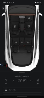

This morning. Checked car to make sure he was awake and ready to accept a pre-heat command later.
Internal temperature 9°C
External temperature -7°C
Last driven on Friday afternoon (that's the day before yesterday), and even then not far enough to warm the cabin. Given the frost on my windows I'll take the -7°C part. 9°C inside? Somebody is having a laugh.
