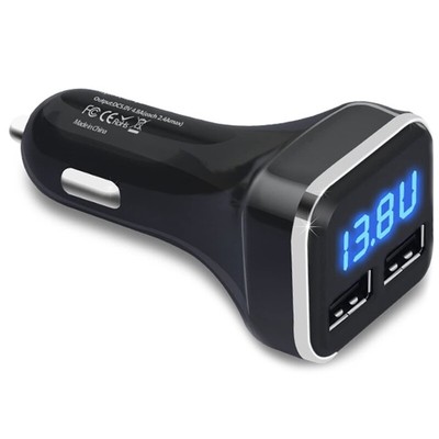

Plug one these into the cigar lighter socket, you can see how the battery is charging.
A bit difficult when the 12v socket is hidden under the centre console :unsure::LOL:
