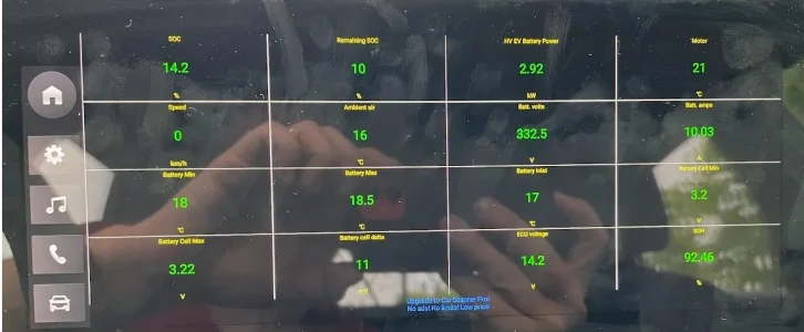

Thanks @hojnikb, Please share a picture showing Car scanner BMS SoC vs Displayed SoC (at any state). You will be doing the doubters out there a great service. ;-). Thanks in advance
Here is it. Displayed SOC on the dashboard was 11% at the time. I suspect it's lagging a bit compared to actual BMS data.
So yeah, at low states of charge there's about 4% difference displayed vs actual %. So i'd guess when the SOC reaches zero, the car might stop or be actually empty.
Guess i'll have to try.

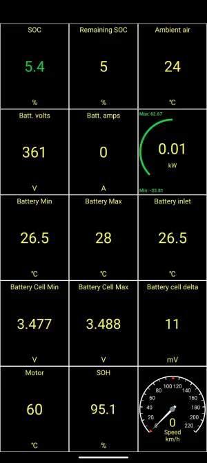

My Luxury (Trophy) with SoH at 95,1%
40300 km (not miles)
I drove 405 km with 100% battery at the beginning.
Nope, mostly B road and city for 100% to 6.
But the screen is only Motorway for the drive I share.
On motorway at 65 mph (100 km/h), 200 miles (330 km) seems to be a standard.
