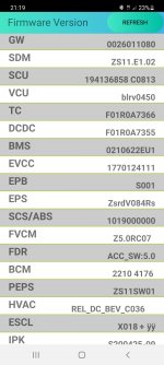

Mine was updated on 12 Feb at chorley group Burnley, I have the eu1
Just adding it to the spreadsheet now :)

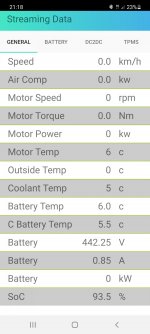

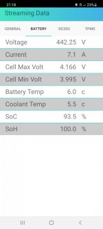

Interesting your SoC is 93.5% at a voltage of only 442.25.
(As mine is 93.2% at full charge with 449Volts)
Can you confirm, this is with the car after a 100% (AC) charge and, very importantly - with no load i.e. the car is started without the brake pedal depressed (so HV battery is off) as this affects the voltage.
Thanks :)

Yes it was fully charged and equalised with everything off

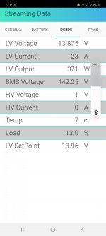

I can't explain the low voltage. Anyone???
On the Streaming data - Battery screen, it shows the Current as 7.1Amps, which would suggest it's pulling some load?
Your Min and Max cell voltages are not that close either - 4.166 / 3.995 (0.171 diff)???

I'm thinking it's just needing a decent balance.
4.166V*108cells would give 449.93V. Could be it's reaching its cut off point, and hasn't started balancing properly yet. There may be enough low cells to drag the overall voltage down, but enough full cells to trigger the end of charging.

If it was definitely 100% on the dash and equalisation had finished and 442V.
Then I'm guessing you had the dodgy BMS and need to do several cycles of equalisation to get to 449V

I'm going to ask loads of questions!! These are what we record on the spreadsheet. It'll prob help explain what's going on a bit :)
When was your car registered?
Last update was 12/2/2021
Have you got Comfort 2 update installed?
Can you AC charge unlocked?
Can you do a times charge?
Have you got the fancy Mode/Kers graphics
Have you had the battery heater option for some reason (unlikely)
Car model = Excusive
If your car was collected or updated between 24th October and before January this year it probably would have had the buggy bms which explains your low voltage which will recover after several battery cycles.
