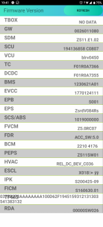

ECU Module version spreadsheet
Oh dear!
I assume you're running ver 1.2.1
Could be the obd2 gadget maybe that you've got, maybe the android device....
Ver 1.2.1, yes. I don't have another Android device to try it out on. It might be the OBD device. I have no idea. Use the info if you can.
I've got practically all of the data from your screen shots, spreadsheet updated.
You and @JohnG are the only people with that version of the EPS.
I'm guessing it's because you both have the battery heater option?
