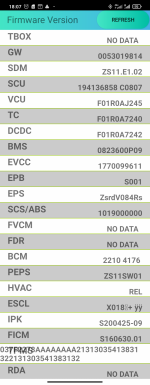

Here is my data, bought the car in February 2021 in Singapore

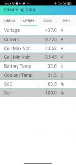

I have the lowest SOH so far, at 99.12%. It also has 64mV of battery imbalance and I don't appear to be able to get below this despite repeated rebalancing. However the range is good and I always measure between 40Kwh - 41Kwh when I recharge (range from 100% to 25% divided by the m/Kwh divided by 0.75). The car was purchased in Jan 2020, has the original BMS, has done 13,400 miles, been on Rapid chargers about 35 times and the rest of the time it goes between 30% and 80% charge. Comfort 2 was done in July 2020, and the HV fuse in Dec 2020. The C2 update ruined the GOM so now it shows 196 miles when fully charged in N3 with all trip counters reset. Turn the HVAC on and the range shows a sensible 167 miles.

@WilsonPranoto Added your data to the spreadsheet... you have a NEW BMS 0823600P09 !!!
It's got to be something to do with your car being from Singapore I assume.
Based on your EVCC / DCDC / TC versions, it would appear that your car is a very early one, as it shares versions of those that are generally found on very early cars.

@JodyS21, I believe going by the name, the BMS software maybe from August 23rd 2020. It cannot charge unlocked and it has the graphic when changing mode, also there is no outside temperature displayed. Fully charged voltage is 455V. Went for my 1000km service yesterday and the dealer here said there is no update for software. Curious what is the difference between the international and UK version besides here in Singapore there is no MG Pilot built in.
Oh I didn't realise you didn't have MG Pilot. I wonder if it is effectively on your car if it shares the same other software, but just not configured to be available.
I'm actually guessing that your 0823600P09 BMS is from 23rd August 2019 rather than 2020, as it shares the "600" part that those very early BMS had in their version name.
No charge unlocked/graphics/no temperature does also suggest it was a early production model.

I'm not too sure about your SOH, maybe it is right, 13,000 miles maybe more than other people have done so far and that's why you hold the title of record lowest SOH so far!
