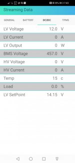

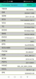

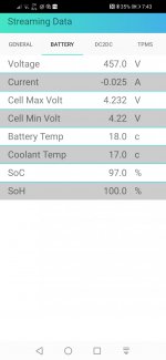

Hi
Not sure if you are still taking these, full charge and balance, not sure which BMS I have?

Hi
That is the June BMS which has issue of long equalisation times but otherwise is good.
Your numbers and voltage all look good , no imbalance.
