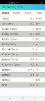

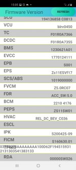

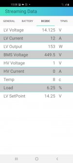

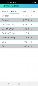

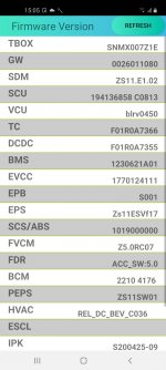

Hi JodyS21, please find my screen(s) from the APP, this from my second car delivered in November 2020, after first car got burned by MG staff as mentioned in my first posting from the OBD project.
BMS update done in late "January", balancing since then on "Granny" @home, some rapid charging since updating, but not more then 10-15 times on 50kW chargers to 80-90% charge.
Screenshot_20210411-150503_ZS EV.jpg Screenshot_20210411-150517_ZS EV.jpgScreenshot_20210411-150545_ZS EV.jpgScreenshot_20210411-150557_ZS EV.jpgScreenshot_20210411-150819_ZS EV.jpg

I've added your data to the spreadsheet.
You have the standard non UK EPS module.
