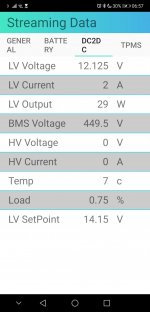

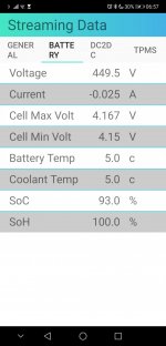

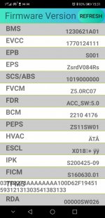

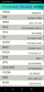

Hi, please find data with 100% charge and equalisaion. Bought car end of December 2020, driven 515 miles, got BMS update on 25th January. Never done rapid charging, all with fast chrager i.e. 7KWH except equalisation on granny charger. 449V on display with 100% charge , HAVC off Economy range 200 miles. HAV off Normal range 182. App data SoC 93%, SoH is 100% with Voltage 449.5 V

I've just posted the test I've done this evening - Low State of Charge / Run Flat Test - with OBD2 Data (8/3/21).
(93.0% - 0.5% SoC)

Ooh I’ll look forward to adding this one in a bit, battery heater option :)
hold on, it’s not read some of the version numbers properly - like BMS :(
Oh, I see. I will try and reread the data tomorrow. The app keeps crashing though, so fingers crossed.
It does crash sometimes if it tries to flip from portrait to landscape (easy done if laid down flat)
It crashes regardless. It seem to be affected by changes. i.e. switching lights off/on, drive move etc, but also crashes when simply switching tabs. Also, the SoH displayed at the "Home" screen is unreliable. Anyway, I tried getting the info you want, but it always misses some information. It must be the way the app reads the data from the OBD. Somehow it is not stringent/consistent. Everytime it crashed or I pressed Refresh, I got different information. But collectively, I think you can make sense of it, so I've attached a zip with multiple images for you to piece together the information you need.
Oh dear!
I assume you're running ver 1.2.1
Could be the obd2 gadget maybe that you've got, maybe the android device....
