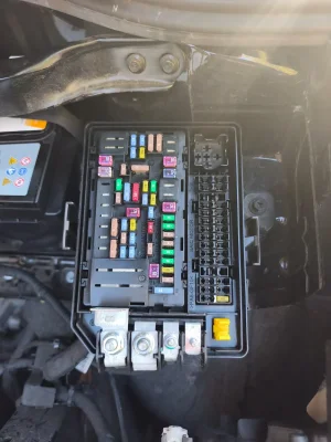

The immobilizer probably connects to the front fuse box. Could you please check if there’s anything unusual or, if you want, send a photo?

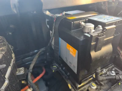

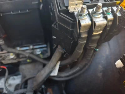

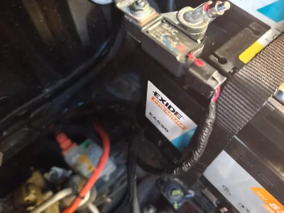

Thanks Geekice, I did look at the fuse box but couldn't see anything obvious, there's a taped wire off the negative battery terminal that looked potentially iffy. See pics below. Any help would be appreciated.

@EVfanatic The fuse box and the negative terminal look fine, so I’m not sure where the immobilizer connects. For the MG4 SE (software starting with SWI69-....-1100Rxx), R13 is very old; the latest available is R40. It brings several improvements and fixes the A/C and Bluetooth issues. I recommend installing R40, then updating FICM and HVAC via SIPS to sort out the air conditioning. Here’s the link for R40, and I’ve attached the PDF with the update instructions.

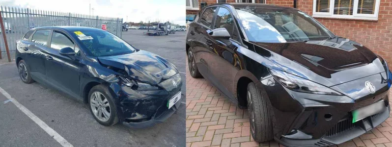

I bought a gamble, a written off MG4 with no speedometer working and a host of faults, I've bought many written off vehicles in the past but never an electric one.
After fixing the bodywork I turned to the computer side of things and none of my scanners (Launch, Xtool) could help with over half the issues. Thanks to this forum I've learnt how to use SIPS, gathered the files and within 24hrs of many many updates, camera and radar calibrations etc the car is now 100% perfect.
The car has cost me about £7k all in which I think is pretty decent for a car with very low miles.
