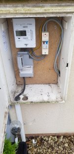

Funny you say that my neighbour has a 100amp fuse so you can't go on fuse size only real way to see is if you or your neighbour has 2 cables going to your fuse
Indeed. Attached is a picture I sent to Ohme (they requested it) and if I were on a looped connection, there would be two black wires going into the fuse at the bottom. I have one, so not looped.
The sticker rating on the DNO's main cut out fuse is not a 100% guarantee of the size of the fuse contained in the casing as @Jomarkh correctly points out.

I have a single cable input.

Thanks mine has a 100amp fuse. So that means that I am not looped???
No necessarily. I had a 100 amp main fuse but the supply came to our house then looped to next door. The way to check is be looking at the cables going in to the meter box. If there are 2 cables from the ground to the meter box you are looping your neighbour. If there is only one cable, doesn't mean the supply isn't looped from either of your neighbours.
My neighbour had a zappi installed without knowing his supply came from the loop at our house. Think the zappy can load balance anyway. When I took my photos for the smart home charge survey, they picked up on it immediately. 2 months later Western Power Distribution dug up the road and my neighbour's drive and unlooped us free of charge.
