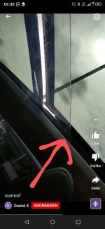

Hi everyone. I think i might have found the area where this annoying noise is coming from after several weeks of relentless search.
It's definitely from the plastic cover inside the boot door (Find picture attached). When you knock the particular area seen in the picture, you'll know i'm 100% correct. Unfortunately, I don't know how to solve this problem.
Hopefully, somebody will know how to rectify this.
